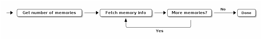

Logical flow
Getting information and reading/writing the memories is optional for the clients, but the -Crazyflie Python Client- always downloads information about the memories on connect.
