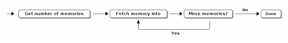

This channel is used to get the number of memories present, information about the memories and the possibility to mass erase memories. The first byte of every packet is a command byte:
| Command byte | Command | Operation |
| 1 | GET_NBR_OF_MEMS | Get the number of memories |
| 2 | GET_MEM_INFO | Get information about a memory |
| 3 | SET_MEM_ERASE | Mass erase a memory |
This command is used to get the number of memories present.
The request from host to Crazyflie:
| Byte | Field | Value | Length | Comment |
| 0 | GET_NUMBER_OF_MEMS | 0x01 | 1 | The command byte |
Reply from Crazyflie to host:
| 1 | Number of memories | 1 | The number of memories preset (all types) |
Example where there are 3 memories present on the Crazyflie:
Host-to-Crazyflie: <port/chan> 0x01 Crazyflie-to-Host: <port/chan> 0x01 0x03
This command is used to get information about a memory give it's id. The id of memories is sequential and is from 0 to one less than the returned number of memories from GET_NUMBER_OF_MEMS.
