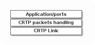

CRTP is implemented in 3 layers:
  • CRTP Link is responsible for transferring the packets between the copter and the PC. It will typically handles packet size and error detection.
  • CRTP Packet handling delivers the packet to the right subsystem in the copter and in the PC control software.
  • Application/ports represents the subsystems that sends and receives messages.
