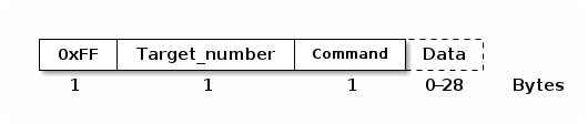

All packets sent to the bootloader starts with “0xFF Target_number”, this kind of packets are called 'NULL Parcket' by CRTP and are ignored by the Crazyflie firmware. The target number has been introduced with Crazyflie 2 as it contains 2 bootloader. The mapping is as follow:

All packets have the following format:
In the rest of this page commands and data are described.
