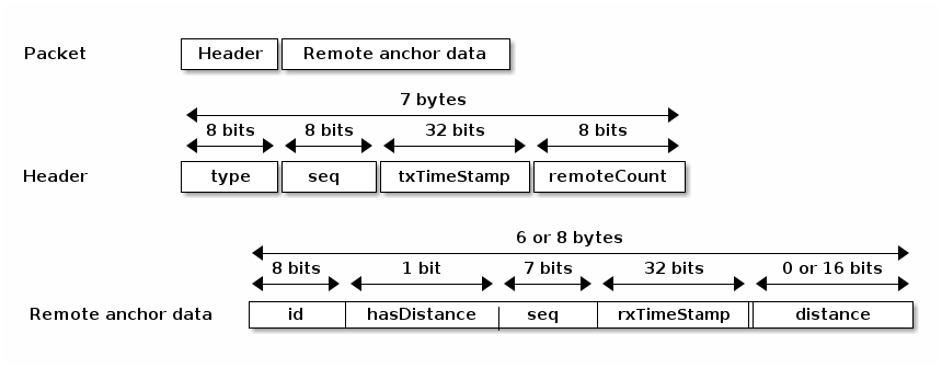

There is only one packet format.
* Header
* Remote anchor data
