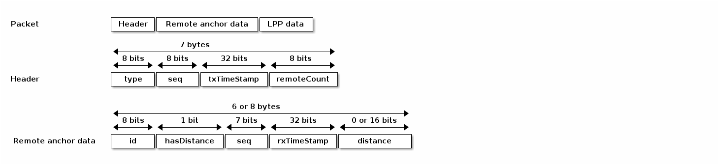

Packet format
There is only one packet format.
  • Header
    • type: 0x30
    • seq: the sequence number of this packet 0 - 127
    • txTimeStamp: transmission time of this packet
    • remoteCount: the number of slots in the Remote Anchor Data section that are populated with data, max 8
  • Remote anchor data
    • id: the id of the remote anchor
    • hasDistance: 1 = distance data is included in the remote anchor data, total length is 8 bytes, otherwise it is 6 bytes.
    • seq: sequence number of latest packet received from the remote anchor 0 - 127
    • rxTimeStamp: receive time stamp of latest packet from the remote anchor
    • distance: time of flight between the current anchor and the remote anchor in radio timer ticks
