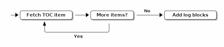

The GET_ITEM TOC command permits to retrieved the log variables name, group and types from the copter. This command is intended to be requested from all the ID from 0 to LOG_LEN (see GET_INFO).

The get info command is intended to be requested first when connecting to the copter. This permits to know the number of variable, the limitations of the log implementation and the fingerprint of the log variables.
