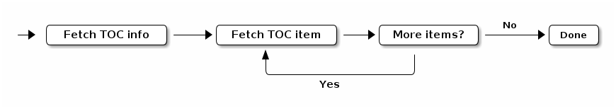

State machines
Downloading the Table Of Contents

Table of content access
This channel is used to download the Table Of Contents that contains all the variables that are available for logging and what types they are.
The first byte of each messages correspond a command. All communication on this port are initated by the client and all answer from the copter will contain the same command byte.
TOC command byte Command Operation
0 GET_ITEM Get an item from the TOC
1 GET_INFO Get information about the TOC and the LOG subsystem implementation
Get TOC item
The GET_ITEM TOC command permits to retrieved the log variables name, group and types from the copter. This command is intended to be requested from all the ID from 0 to LOG_LEN (see GET_INFO).

Get Info
The get info command is intended to be requested first when connecting to the copter. This permits to know the number of variable, the limitations of the log implementation and the fingerprint of the log variables.
