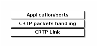

CRTP is the protocol used to communicate with Crazyflie. Is originally stands for Crazy RealTime Protocol. The protocol permits to communicate independently with the copter subsystem and would have the capability to handle packet priorities.
CRTP is implemented in 3 layers:
  • CRTP Link is responsible for transferring the packets between the copter and the PC. It will typically handles packet size and error detection.
  • CRTP Packet handling delivers the packet to the right subsystem in the copter and in the PC control software.
  • Application/ports represents the subsystems that sends and receives messages.
